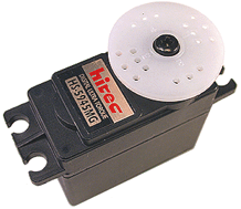

estoi con el 3d quiero que me deis vuestra opinion sobre hacerme de un raptor 50 pero SD y que servos les pondriais en cada movimiento no quiero escatimar en servos

Yo utilizo estos servos en ciclico y paso indeferentemente y hasta la fecha no me han dado problemas:
S9206 Futaba
Control System: +Pulse Width Control 1520usec Neutral
Required Pulse: 3-5 Volt Peak to Peak Square Wave
Operating Voltage: 4.8Volts
Operating Temperature Range: -20 to +60 Degree C
Operating Speed (4.8V): 0.19sec/60 degrees at no load
Stall Torque (4.8V): 132 oz/in. (9.5kg.cm)
Operating Angle: 45 Deg. one side pulse traveling 400usec
360 Modifiable: Yes
Direction: Counter Clockwise/Pulse Traveling 1520-1900usec
Motor Type: Coreless Motor
Potentiometer Drive: Indirect Drive
Bearing Type: Dual Ball Bearing
Gear Type: All Metal Gears
Connector Wire Length: 12"
Dimensions: 1.6" x 0.8"x 1.5" (41 x 20 x 38mm)
HS-5945MG Hitec
Control System: +Pulse Width Control 1500usec Neutral
Operating Voltage: 4.8-6.0 Volts
Operating Speed (4.8V): 0.16sec/60 degrees at no load
Operating Speed (6.0V): 0.13sec/60 degrees at no load
Stall Torque (4.8V): 152.75 oz/in. (11kg.cm)
Stall Torque (6.0V): 180.53 oz/in. (13kg.cm)
Operating Angle: 40 Deg. one side pulse traveling 400usec
360 Modifiable: Yes
Direction: Clockwise/Pulse Traveling 1500 to 1900usec
Current Drain (4.8V): 3mA/idle and 180mA no load operating
Current Drain (6.0V): 3mA/idle and 230mA no load operating
Dead Band Width: 1usec
Gear Type: 3 Metal Gears, 1 Resin Gear
Connector Wire Length: 8.66" (220mm)
Dimensions: 1.55" x 0.78"x 1.48" (39.4 x 20 x 37.8mm)
Weight: 1.97oz (56g)
Por Sulawesi
#330635
Aqui tienes el Hitec:
Por corderon
#330659
yo llevo esos hitec y me van de maravilla.
