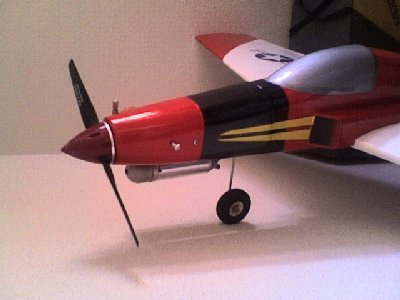

dentro de unos dias tendre este parato, es un regalo. las fotos no pertenecen al avion ya que el mio sera en la caja, sin motor ni electronica. pero para daros una idea del modelo que digo es el phoenix model
alguno lo a volado ? configuracion correcta ?

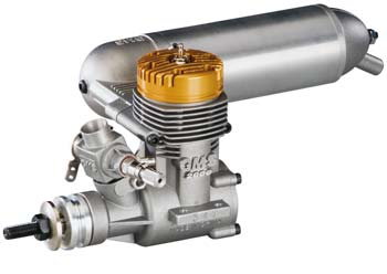

motor: GMS 47 ABC BB
FEATURES: Ball bearing-supported crankshaft
Front-mounted High Speed needle valve
Low Speed needle-equipped carburetor
Aluminum Brass Chrome piston/sleeve construction
Adjustable exhaust outlet on muffler allows 360° rotation of
muffler tip
Gold anodized heatsink head
One piece crankcase with a bead-blasted finish
2 year warranty on all GMS engines
INCLUDES: One .47 airplane engine
One bolt-through muffler
One carburetor
One muffler gasket
One glow plug
Two allen key tools
Two muffler screws
One manual and parts list
REQUIRES: Attaching High Speed remote needle valve and muffler.
5-15% airplane nitro fuel.
10x7 break-in propeller
SPECS: Displacement: .47 cid (7.72cc)
Bore: 22.4mm
Stroke: 19.6mm
Output: 1.47 BHP at 15,000 RPM
Practical range: 2,000 - 16,000 RPM
Weight: 475g (with muffler)
Center distance width across mounting holes: 1.7" (44mm)
Center distance length of mounting holes on same side: 0.69" (17.5mm)
Length from front of crankcase to backplate screws: 3.4" (87.3mm)
Width across mounting flanges: 2.0" (51.5mm)
Total height of engine: 3.43" (87.3mm)
Length from center of head to front of crankcase: 2.4" (61.8mm)
Widest width of crankcase neglecting mounting flanges: 1.4" (35.7mm)
Length from front of crankcase to center distance of front
mounting hole: 2.1" (53mm)
Height from crankshaft center to top of head: 2.8" (71.2mm)
Crankshaft thread size: 1/4-28
COMMENTS: Sport Model: 10x7, 11x6
Racing Model: 9x6
Scale Model: 11x6
creo que le metere este motor- ¿ bien?

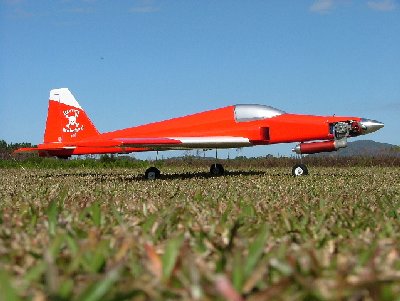

Este es un poco diferente (es un DF).
Por lo que he visto en tu post, eso tiene pinta de que va a ser un misil. Prepárate para volar a tope.
Desgraciadamente no vas a tener mucho juego de elección de las hélices. La mejor, según creo, la 11x6.
Perfil muy finito+poca envergadura = volar a tope (a mi me encanta)
Suerte y Saludos.

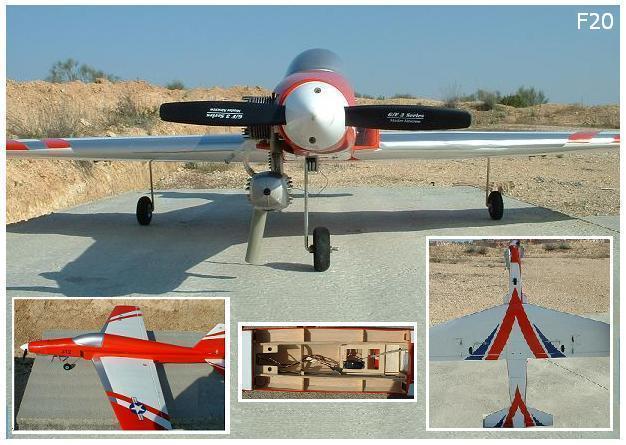

Por tinomarper

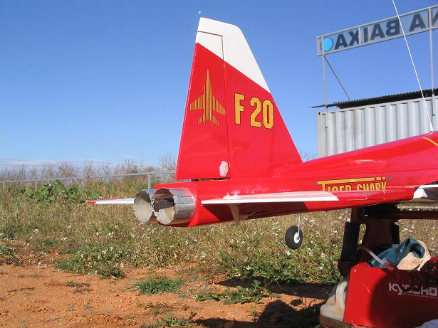

#448836
alguna consideracion a la hora de montarlo ? esas toberas, no las trae de serie ¿ como las has hecho ? quedan muy bien.

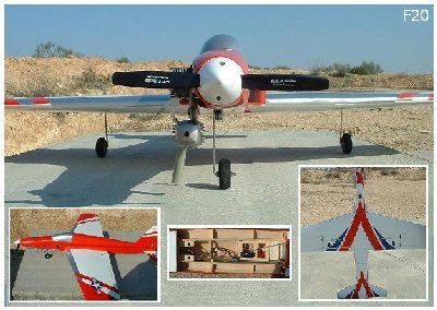

#448925

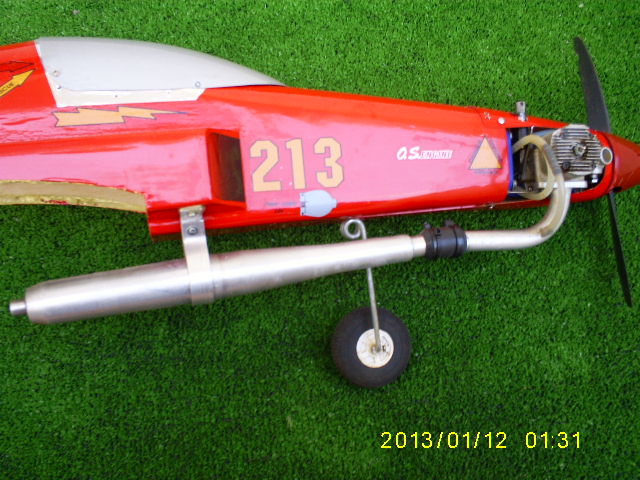

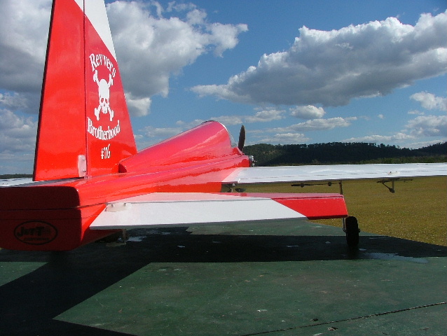

Hola amigos, mi F20 ya ha realizado con éxito muchas misiones (OS46AX-10x7). Como bien se comenta, es un avión muy estable, fácil de despegar y aterrizar. El servo de la rueda de dirección se puede sustituir por una varilla unida al servo del timón de dirección, también se le puede poner unas ruedas un poco más pequeñas y es recomendable reforzar la cuaderna para-llamas, porque al final se despega (me aviso Raptor34). Vuela muy rápido, sobre todo los últimos minutos de cada vuelo cuando lleva poco combustible. La decoración es un poco pobre, pero eso es fácil de solucionar. Supongo que un motor GWS debe ser la bomba. Es un avión muy divertido.

Por Eladio-g
#449458
Bueno las toberas estan hechas con aluminio de 0,2 mm.quedaba muy soso el trasero. Seguramente con el envase de un "petitsuise" ligeramente pintado tambien quedaria bien.
Lo de la rueda trasera creo que es un efecto optico, realmente es la rueda del ala izquierda.
Eladio

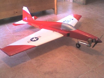

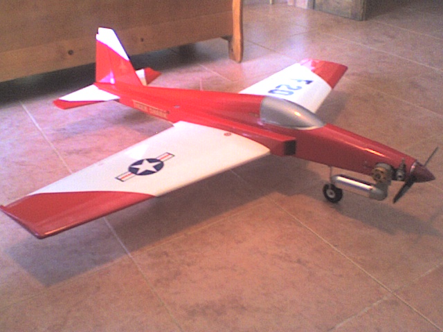

Ya esta montado el tigershark F20 , en orden de vuelo, 2 preguntas antes de su vuelo inicial.
- habeis respetado los recorridos que aconseja el fabricante?
aleron 8mm
direccion 15mm
profundidad 12mm
los e puesto asi pero no se me parece poco recorrido sobre todo en profundidad.
- ¿ aterrizais con los alerones bajados a modo flap ? ó no es nesesario .
e estado probando el motor GMS 47, en el trainer MKII y es una bestia como tira el tio.... en el F20 ira perfecto.
Última edición por tinomarper el Sab, 19 May 2007 0:45, editado 1 vez en total.
Por tinomarper
#471882

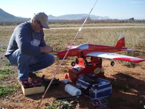

hoy a sido el estreno del F20, la sensacion a sido muy satisfactoria. un vuelo muy plano no he tenido que trimar nada, y muy rapido.. sin pasarlo de medio stick.
incluso a tenido una parada de motor por mi culpa ya que no habia regulado muy bien la bomba perry, a entrado muy rapido a pista pero se ha comportado como un campeon. a terminado aterrizando en el campo de cebada que hay al final de pista y ni un rasguño...

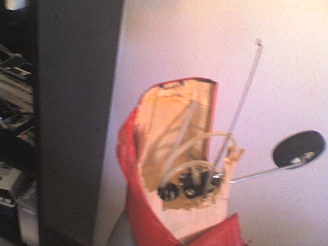

#484030

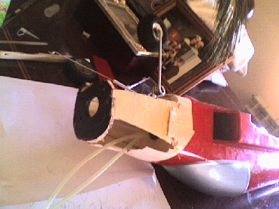

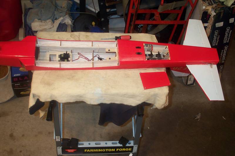

pues eso.. despues de unos cuantos buenos vuelos, le voy a hacer un giro para encararlo a pista para aterrizar y prfffff! cloff cloff! ...se me para el motor estaba a poca altura... y no demasiada velocidad, con lo que empezo a perder altura rapidamente. intente picarlo un poco para que ganara velocidad y despues tirar de profundidad pero. este bicho como de profundidad no lleva mucha que digamos pues cuando tire de el no llego a ponerse plano sino que toco morro con el suelo ..... en fin helice rota. morro escogorciado; lo demas bien .... en un par de tardes ya esta en orden de vuelo...
despues de un par de tardes......
el oracober sustituido es imitando a fibra de carbono... no tenia por aqui rojo a si que chapuzilla pero vuela...
maderita por aqui... pegamento por alla..
asi quedo
asi era...

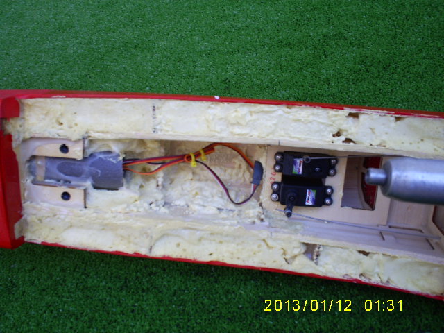

#1190089

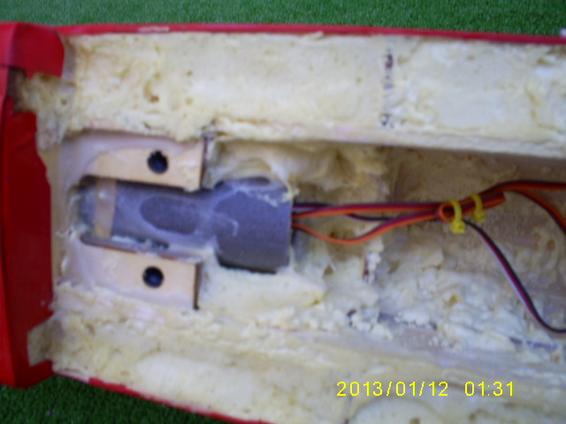

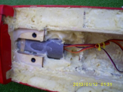

saludos os comento que el avión es un tiro tengo uno con os.46 ax pipa y heder , el avión no solo es débil en la punta es débil todo el fuselaje pero vuela excelente yo lo e reforzado tirando-le espuma liquidad por dentro a todo el avión aparte que es super liviano le da una dureza increíble , por cierto te a quedado muy chula esa reparación saludos.
#1190390
Partiendo de que soy super ignorante en todo lo que se refiere a montaje y demas. Podeis decirme de forma mas clara como reforzar el parallamas, que necesito, donde comprarlo y como se hace??
Se que es mucha info pero estoy muy perdido y quisiera estrenarlo ya.
Gracias y un saludo.
#1190417
planatlas escribió:Partiendo de que soy super ignorante en todo lo que se refiere a montaje y demas. Podeis decirme de forma mas clara como reforzar el parallamas, que necesito, donde comprarlo y como se hace??
hola capitan entre la pared de fuego y el tren delantero hay un espacio y una tapa pues por hay lo puedes reforzar con madera y si quieres mas dureza me tele goma espuma liquida ojo tienes que tener cuidado con el tren que no se llene de goma espuma y tienes que tener las manguera y la varilla del acelerador pues y enfundada para que puedan movilizarse y tambien puedes reforzar con fibra pero para mi la mas efectiva es goma espuma saludos.
#1190459
planatlas escribió:Donde se compra eso???
si hablas de la goma espuma liquida en Leroy capitán el botle mas barato te sirve eso es un poquito nada mas . antes de hacer algo prueba como se usa en una bolsa para que mas o menos te fijes .
ESPUMA DE POLIURETANO MARCA SUPER FOAM
