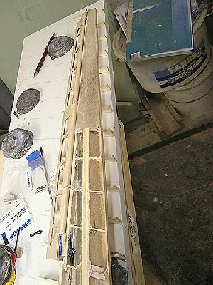

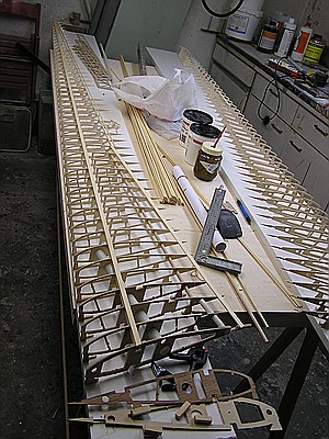

CK-Wings asked me to post here something about my newest projekt.

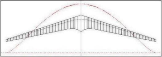

It all started with the nurfluegel.exe from Frank Ranis.
After this I made a drawing in Mega-cad (similar to auto-cad).

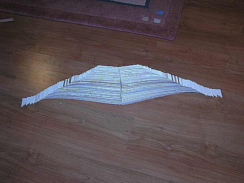

The datas were sent to a friend of mine who has a CNC-Milling-Machine.
The ribs together with some pieces of wood became a wing :D

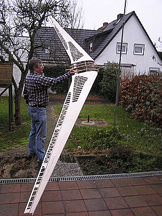

The result till now is hold by me on the last picture.
Technical dates:
Span: 5 m
weight 6,5 - 7,0 kg
Ca 0,5
Speed: 13-14 m/s
Please apologize, that I write in english, but I donnot understand a word spanish.... :oops:
Regards
Lothar

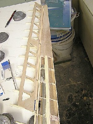

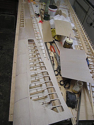

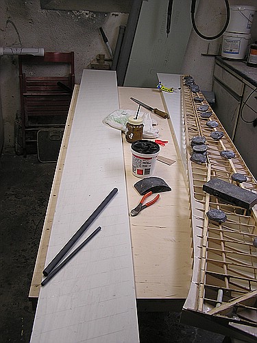

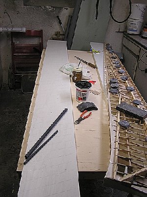

I worked a bit at the center section an the bottom side of the wings. I built a second "helling" to put the wings upside down in it. This makes sure, that the twist of the wings will be absolute correct. I believe somebody here had his bad expierence with this...
I can tell You, that when this bird goes in the air, I keep You informed. But I believe, this will still take a few weeks (months)....
Here are some new pictures:
Lothar

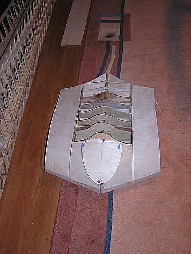

one wing in the helling for working on the bottom side

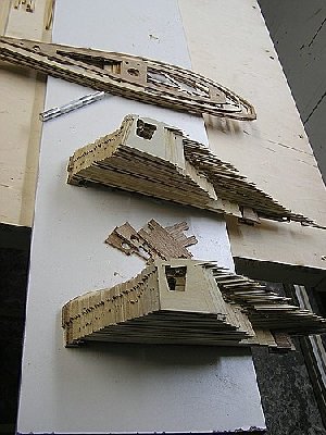

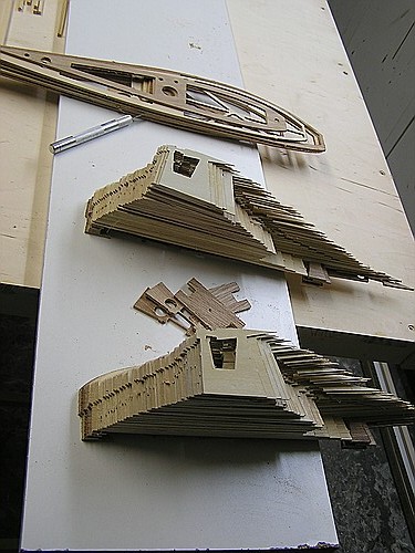

runners box
Center section
Helling Ribs

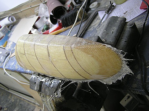

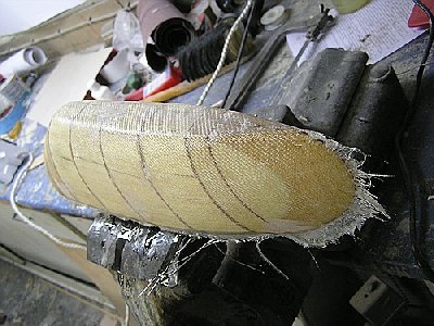

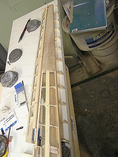

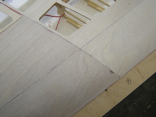

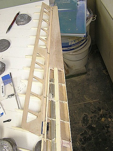

I worked a bit on the ailerons and Flaps. This was a bit difficult in this small outer-wings. But I belive, it works now.
Lothar
aileron up
aileron down
